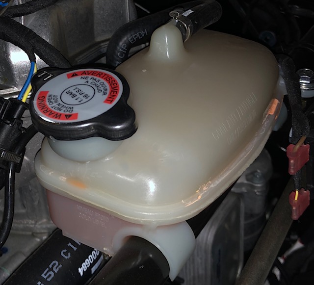

I don't think I will be riding it to the dealership. it is not worth the risk. went outside a took a picture. Should this have been filled up completely? like I said I have only had the bike for about a week.
Re: High engine temp / limp mode
Posted: Thu Apr 11, 2019 12:08 am
by Thechamp73
No it is not. Check your owners manual.

Hi all, Im thinking there are gremlins in our bikes :), seriously thanks for this heads up.
I too had my own scare with warning lights not long after break in 2 weeks in, on a short ride heading home on highway and slowing for major intersection, the ! Light flashed once lucky I saw it it was that quick on /off again, but its never poped up since. As for the issue at hand my water level looks that low hard to see markings on tank but full I think is half way I've had no problems temp gage gos to half way and fan on if sitting for long periods.
