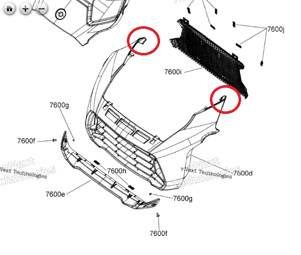

by Freezefm
2 screws hold the front fascia, located under the radiator.
Then the front fascia comes off by prying on the sides.
The grill is held on to these tabs by the 6 flat clips.

I saw your post here to remove the front fascia. Is it just two bolts holding it on underneath? Can you give me an idea where to pry it off. I have to do some surgery to the Ryker myself.
Yes, just 2 screws underneath. Pry from the top corners.
Francis
Re: Rally radiator stone guard?
Posted: Thu Aug 08, 2019 8:38 am
by Freezefm
Pry at these locations...
Francis
